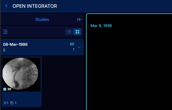

The OHIF Viewer documentation explains how to change the viewer logo under the Viewer Theming - Whitelabeling section.
Essentially, you need to modify the OHIF app-config.js file, adding a whiteLabeling section.
The end result looks in my case like this:

Option A) You can replace the logo section with a text section like this:
  whiteLabeling: {
    createLogoComponentFn: function(React) {
      return React.createElement(
        'a',
          target: '_blank',
          rel: 'noopener noreferrer',
          className: 'text-white underline',
          href: 'https://openintegrator.com/',
        React.createElement('h5', {}, 'OPEN INTEGRATOR')
Option B) You can replace the logo section with an image like this:
 whiteLabeling: {
        'a',
          target: '_self',
          className: 'text-purple-600 line-through',
          href: '/',
        React.createElement('img', {
          src: './customLogo.svg',
          // className: 'w-8 h-8',
You can place the whiteLabeling section for example, just before the hotkeys.
My full app-config.js looks like this:
