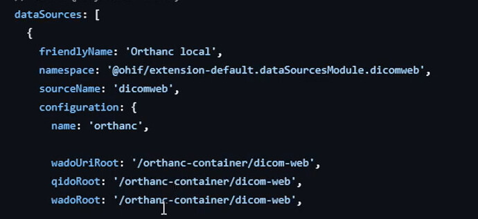

Your Orthanc video is excellent, however, it wasn’t clear to me how to create the Dicomweb resource so I can use it, for example, in a front-end I’m developing, because with Rest-api in Python or Node.js on the web there are many resources. I already use Ohif on a local server. Thank you for your attention.
Hi @Luciano_G_Vaz,
ok I see that in the above linked installation video the OHIF config points to the Orthanc local with the waroURIRoot etc. parameters but perhaps those are just the local addresses which work inside the container and it’s not clear how to use those endpoints from outside the container?
Did I understand the question correctly?
I’m not sure what the dicom web endpoint in this case is but I can try to have a look at it later.
